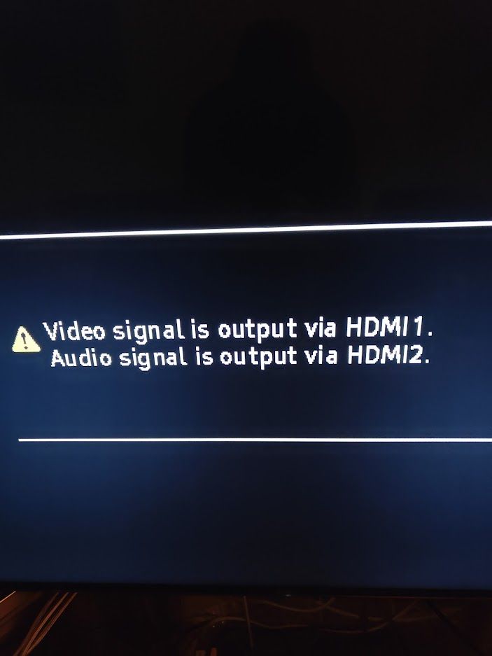

A new SACD that I bought plays back in complete silence. No music.
This is the display.

Sadly, both options failed.
Option 2 produced the result seen in the photo.

Are you using an HDMI connection from OUT 1 (Video/Audio), with no Bluetooth device also connected, and with the settings:-
[Audio Settings]
[Digital Audio Output]
[Auto]: Normally select this. Outputs audio signals according to the status of the connected devices.
DSD Output Mode]
[Auto]: Outputs DSD signal from HDMI OUT jack when playing Super Audio CD & DSD format file (if the connected device also supports DSD).
Outputs LPCM signal from HDMI OUT jack when playing Super Audio CD & DSD format file (if the connected device does not support DSD).
[Music Settings]
[Super Audio CD Playback Layer]
[Super Audio CD]: Plays the Super Audio CD layer.
[CD]: Plays the CD layer.
[Super Audio CD Playback Channels]
[DSD 2ch]: Plays the 2ch area.
[DSD Multi]: Plays the multi-channel area
[Off]: Outputs PCM signals from HDMI OUT jack when playing Super Audio CD and DSD format file.
[HDMI Audio Output]
[Auto]: Outputs audio signal via HDMI OUT 2 jack if it is connected to a device and the device is turned on. Otherwise, outputs audio signal via HDMI OUT 1 jack.
[HDMI1]: Outputs audio signal via HDMI OUT 1 jack.
[HDMI2]: Outputs audio signal via HDMI OUT 2 jack.
I suspect this last setting may be key; make sure the audio is going with the video to the TV, at least as a test, and not to an AV receiver that is switched on, but not playing, or which can’t do DSD.
I can see the merits of trying PCM to at least see if some sound can be detected, but it’s not a fix, as you might as well play an ordinary CD in stereo for the same result, which would make having SACD a bit pointless.
Which might be the case even via the TV, unless the audio is going out DSD to an AV amp over eARC. I get my best audio splitting the output from my 4K player to be video only from the video/audio HDMI to the TV, and the audio via the audio-only HDMI direct to my soundbar.
Though admittedly none of my kit involved in this is Sony kit.
My favourite bedtime reading is a Sony product manual…
