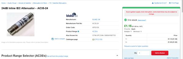

That it picks up all those channels with just a short fly lead attached suggests you have lots of signal flying around. Without knowing the installation and aerial setup it's impossible to advise really. For example is your aerial a single system, one aerial feeding the downlead into the room, or is it amplified and distributed to many rooms, or is it a communal aerial system perhaps.
An attenuator is the recognised way of reducing level, but you would have to experiment and there are no guarantees. They can be 'stacked', that is one plugged into another to make different values. Fit the attenuator at the recorder aerial input.
If you do try one then I would say go for at least 15db or even more as a test. 15db would reduce the level by over 80% A 24db would reduce it by almost 94%
I will stick with the short fly lead for the time being as the machine is working as it should, and accepts those EPG updates at 6.am 10.am 2pm without getting stuck.
Which was really the main problem.
