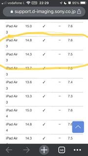

I'm struggling to transfer images from my new camera to my iPhone. As far as I can tell, the camera is connected to home WIFI and has connected to my phone. The process starts but then I get a message to say the process has failed.

My iPad is an Air 3 running iOS 14.7.1 and Imaging Edge Mobile 7.6.
Is this compatible? It works.
confused much 😞
HannahEd01
@plumduff, on the link it doesn't say it supports 15.4.1, it only says 15. That might be the issue here.
plumduff
This is true. It doesn't say anything at all about iOS 15.4.1 which isn't very helpful. I've now had an update to 15.5 and it's still not working ☹️
