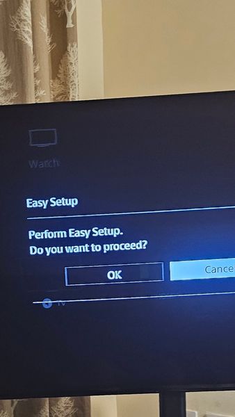

Blumine1818
All of a sudden pressing home has prompted a screen message asking if I want to perform easy set up!
Blumine1818
Blumine1818
I don't know how to thank you but
IT IS WORKING!
The software has updated and all is well!
royabrown2
Hero
@Blumine1818
Result!
It looks like the soundbar had crashed - maybe it got crashed when the previous TV went wrong, we never did explore what actually happened there, or maybe it attempted a software update that got stuck, or maybe it’s just that ‘stuff happens’  - and the factory reset, first attempt or second attempt, worked, and rescued it.
Hopefully, you can, or have, got it back as good as new now.
