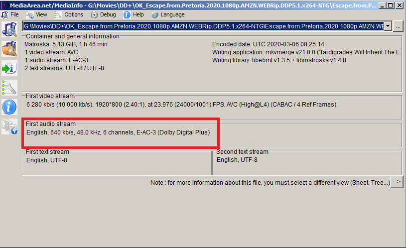

thanx for ur reply..
the pb is not "no sound" when playing DD+..pb is AVR is downgrading (to DD5.1) or not decoding (it is Supported DD+ ) when plays any DD+ content ..netflix or players (kodi archos or native player)..
F.ex;
Escape.from.Pretoria.2020.1080p.AMZN.WEB-DL.DDP5.1.H.264-NTG.mkv
if i play this movie directly (from TV ARC to AVR ARC) from native player,Archos Player or Kodi, AVR shows DD5.1..
if i play this movie from Laptop or AndroidBox ( TV connected to AVR with ARC and from Laptop to AVR with HDMI port ) AVR shows DDP5.1..
