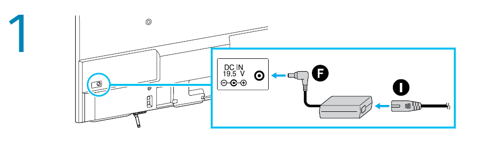

Is your power supply an external 19.5V DC like below?
