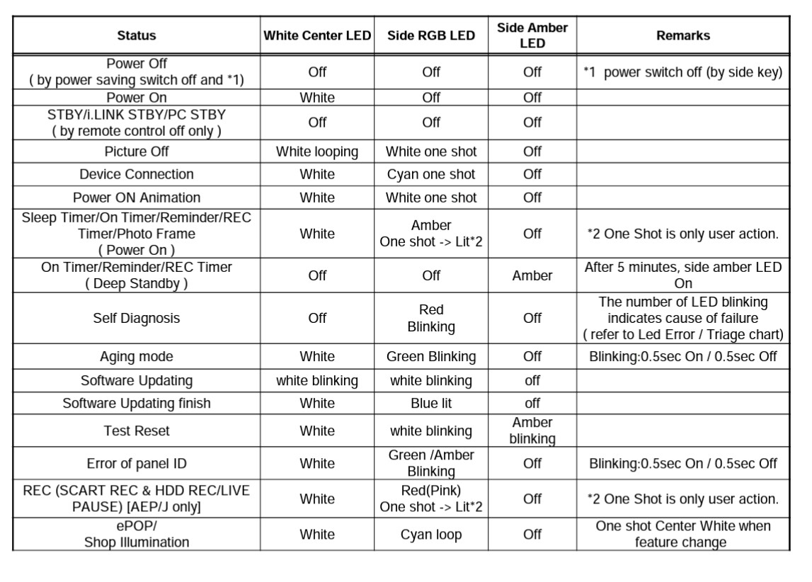

I noticed that the illuminated sensor below the screen of my 2015 Android KD-43X8309C was lit up pink, not white, today, when I was watching YouView.
The two-minute power off did not change this, so I looked in the manual, and it says pink is 'Recording Mode'.
So I got all excited at first that this had been finally added to YouView, and then I thought, hang on, there's been no update.
I finally traced it to Timer On and Off, which toggles between pink and white as you change the setting here.
But this isn't quite Recording Mode, is it? There is little enough in the Reference Guide, without Sony getting this wrong, and in nineteen languages to boot 😞

Try http://pdf.crse.com/manuals/4559966111.pdf page 7(GB), as below.
This manual, printed, came with my TV, but does not seem to exist under KD-43X8309C Support on the Sony site, though it is there under other models that it refers to, the '5 and the '7, though not the '1 either. And the link above is from the '7 page, which is where I found it to reference and reproduce.
Must be all these different MotionFlow values that I don't believe are really different unless certain stand and bezel colours react badly to certain rates; but how could you tell?
I now see that 'Timer is set' is supposed to be Amber, but it does not look Amber to me. Try it on yours, and see what you think.

Tried it on mine - its Amber :nauseated_face:

It could be amber, I suppose.....without a real pink to compare, it is difficult 🙂
