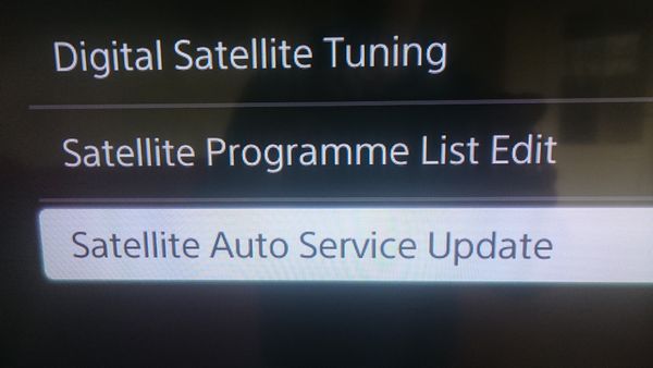

Caledonian_TV
Contributor
@Peter_S. wrote:
Hallo everyone,
There's some other options to avoid channel refreshing when receiving your channel via satellite.
undefined
Can you please check if those are disabled as well?
Thanks a lot in advance
Cheers
Peter
As I've said before... And seems to be the case with others. This makes no difference!
