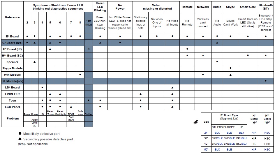

Service Menu/Service Manual - Unfortunately I do not know how to get into the service menu of 2013 and 2014 tvs. I am under the assumption though that you need a "Service Remote Control" in order to do this. I have not been able to confirm this, because I can only ascertain the first 100 pages of the 2013 W6 Service manual (and the required service menu is on page 200ish!!)
As you now know, it can be done, therefore its a PC software/driver issue (assumption!), also not sure how helpful the service menu for this is anyhow.

Something that may assist in the 1/3ish that I have:
I have PMed you the link to the SM.
Don't know how useful - but seriously - Good Luck !! and please let me know how you get on.
