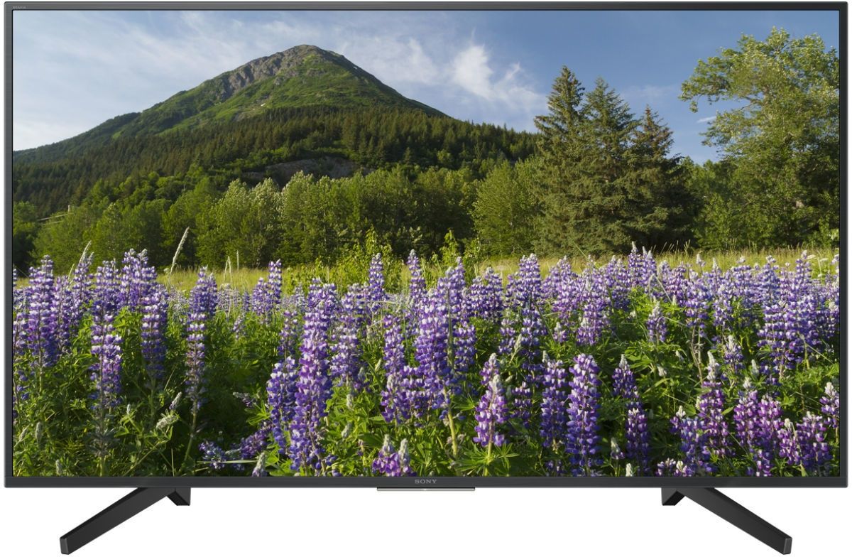

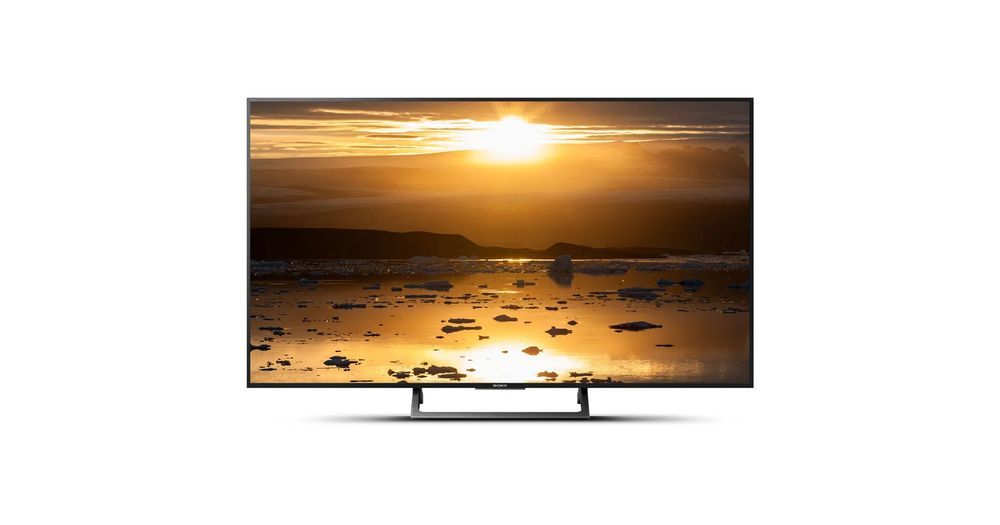

Below are images of the two different TVs, the KD-437000E is first with the sunset, the KD-55XF7003
is the lower image with the mountain scene, which one is your TV.
