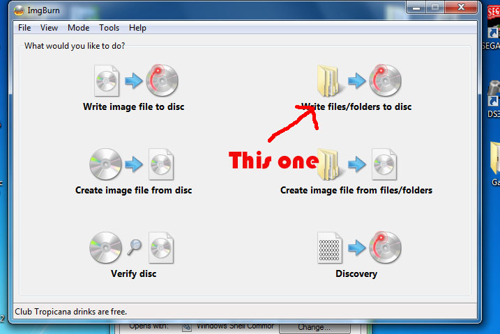

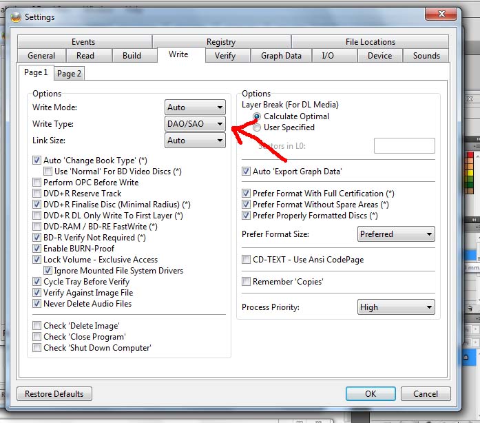

My question is this though: How the heck do people update their firmware? I've followed the advice from HERE and
downloaded the file sr08S124.mem and have tried burning it to a CD-R using several different methods but I keep getting "CAN'T USE" on the front display and "incompatible or unreadable disc" on the TV screen (Using the method in the link above I've determined that my current firmware version is V1.15 BTW and also that the mem file has downloaded fully).
I've used Imgburn with the settings suggested by the link (disc-at-once mode and ISO 9660 CD-ROM file system format)
Nothing I try works- I keep getting the "CAN'T USE" and "incompatible or unreadable disc”. I've even downloaded a trial version of Nero Burning ROM 12 to see if burning CD-Rs with that would make any difference, but with no success either. So far I've wasted about 6 CD-R's on this so it's starting to get pretty annoying. I even found a couple of old CD-RWs that I've formatted and tried it with but I just a No disc inserted message with those *eye starts involuntarily twitching*. Just to clarify as well, I've followed the instructions in the link to press and hold the Rec-Stop and then the Play buttons on the actual unit, so I'm not trying to load the disc incorrectly using the remote or anything like that.
