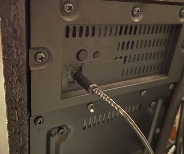

Apologies, but I don't think I ever came back to you on your question.  Photos of the sub and soundbar panels (with cable) attached.  As I said previously, this stopped all the sound cut outs completely.  For the sakes of a few quid for the cable, it was worth it for me. Fully understand that for those who don't want to, or can't go this route that it is unacceptable.
Soundbar rearSoundbar rearSub rearSub rear
