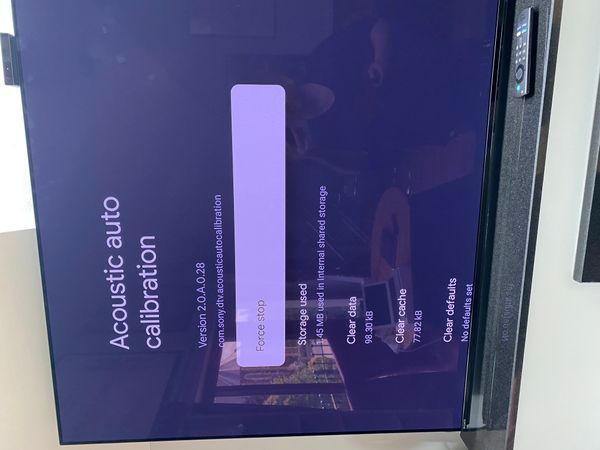

When I run this on my TV it immediately takes me to a screen with info on the app e.g. Force Stop, Clear Cache etc. It doesn't actually run itself. Switched off/on, reset, updated etc, no change.

Unfortunately not because when I try to start the calibration app on the TV it doesn’t work. I just get a screen with info on the app e.g force stop, empty cache etc.

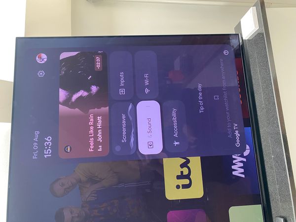

Have attached a series of photos of what I'm doing and the final result.

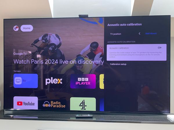

First thing I notice in the third image the acoustic calibration button is set to off.
Click on it and it should move to the right and turn blue, indicating it is on.
does that make any difference.
Is it possible for you take the images of your screen directly in front of the TV rather than to the side and preferably
in landscape format.
Unfortunately when I toggle acoustic calibration to on the same thing happens - it takes me to the same "Force Stop" etc screen as if I was trying to run the calibration app. Landscape photos attached.

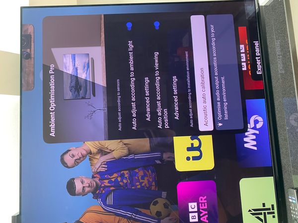

I also see you are accessing the Sound settings via the Settings icon on the Home page of the TV.
If you are able try accessing by pressing the Settings button on the remote control,
click on Settings on screen Scroll down to Display & Sound, click, on the right hand side
scroll down to Sound and select Auto acoustic calibration.
see if doing it this way gets you any further.
