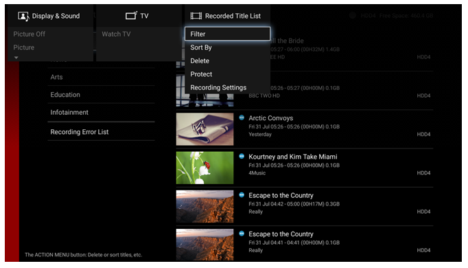

im guessing the 1st thing i should notice when it is correct, is a record menu?
this is a image from the FAQ - and presumably will be the same for the KD-55S8005C
rooobb
This is what you should see pressing the Title List button too (obviously empty).
What seems strange to me is that you said you formatted and verified the HDD: did you do it on the TV or are referring to some PC operations you did on the HDD? Sorry if it seems a stupid question...
